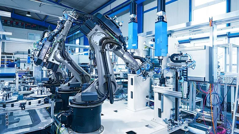

This automated assembly line features several servo presses. Photo courtesy Kistler Group
Manufacturers can meet all of these requirements with electromechanical servo presses. With the right system, manufacturers can reduce their initial outlay and subsequent operating costs, while also cutting carbon emissions.
Compared with pneumatic and hydraulic presses, servo presses offer higher efficiency, precisely adjustable pressing force, and excellent repeatability. Integrated sensors make it possible to accurately monitor force and displacement. By gathering, analyzing and documenting process data in real time, servo presses deliver seamless quality assurance. Servo presses also reduce waste through optimized process control. Preventing scrap saves resources.
