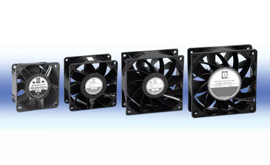

Orion High Static Pressure Family
High static pressure fans typically feature specially designed/curved blades that not only deliver high CFM values, but also focus air movement to push/pull air through obstacles for efficient cooling. Source: Orion

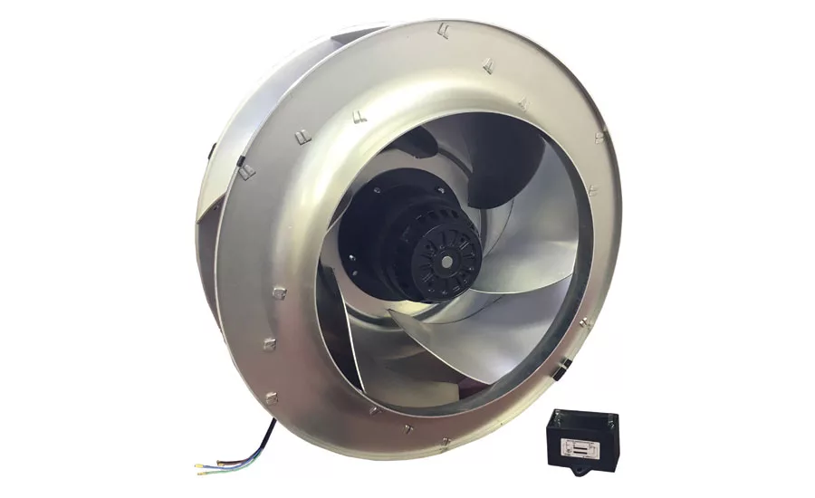

Orion OAB400 plus Cap2
AC blowers, like the OAB400 Series, feature an all-metal impeller, sealed dual ball bearing design, and rugged die cast aluminum frame. Source: Orion

Designed specifically for highly restrictive environments, a high static pressure DC fan can deliver superior airflows up to 283 CFM, with a low weight-to-output ratio, and maximum static pressure value up to 3.90 inches of water (H2O) column. Ordinarily, most 120mm fans on the market offer maximum airflows of 105 CFM with a maximum static pressure of 0.24 inches of water. However, today’s 80mm high static pressure fans can outperform a standard 120mm fan, by offering airflows up to 141 CFM with maximum static pressure values of 3.90” H2O, not only providing higher airflow, but also significant space savings.
High static pressure fans typically feature specially designed/curved blades that not only deliver high CFM values, but also focus air movement to push/pull air through obstacles for efficient cooling. Additional design considerations include the number of blades per fan, various operating speeds, and size of the motor. In order to reduce energy consumption of equipment running for long periods of time, adding intelligent controls to the fan in order to meet energy saving demands is becoming more popular and practical. High static pressure fans with special function options including PWM, tachometer, alarm and thermal controls can feature up to 30% energy savings; up to 50% at lower RPM speeds. These types of solutions help meet application energy requirements when systems are operating 24/7.

For larger applications, motorized impellers and blowers offer a space-saving design, simplified installation and mounting, and maintenance-free operation. Blowers and motorized impellers produce a high volume of air that can be concentrated or directed more effectively to deliver better commercial and industrial ducted air movement. These blowers and motorized impellers combine high efficiency with small size to significantly lower the intrinsic heat in the system. The low-profile design of the blower provides excellent airflow over the motor itself, ensuring low internal operating temperatures and substantial energy savings.
High static pressure AC motorized impellers usually feature backward curved blades to provide high airflows up to 1900 CFM and maximum static pressure of 5.4” H20. AC blowers feature an all-metal impeller, sealed dual ball bearing design, and rugged die cast aluminum frame.
