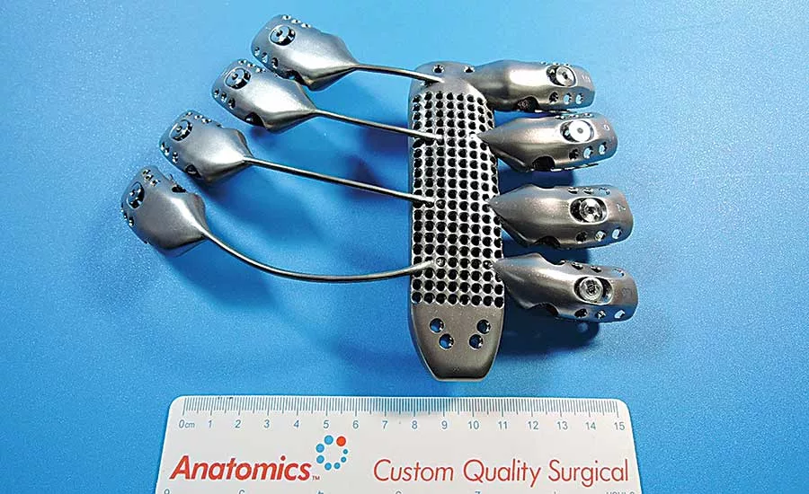

Made from a titanium alloy, this artificial rib cage and sternum were created with an additive manufacturing process called electron beam melting. Photo courtesy Anatomics

To create the patient’s new sternum and rib cage, Anatomics engineers began with high-resolution computerized tomography (CT) scans of his chest. A CT scan combines a series of X-ray images taken from different angles and uses computer processing to create cross-sectional images, or slices, of bones and soft tissues inside the body. Data from the CT scans was then used to create a digital 3D model of the man’s rib cage.
“From this, we were able to design an implant with a rigid sternal core and semi-flexible titanium rods to act as prosthetic ribs attached to the sternum,” explains Anatomics CEO Andrew Batty.
The team then manufactured the implant out of surgical-grade titanium alloy using an EBM system from Swedish manufacturer Arcam AB.
“We wanted to 3D print the implant from titanium because of its complex geometry and design,” Batty says. “While titanium implants have previously been used in chest surgery, designs have not considered the issues surrounding long-term fixation. Flat and plate implants rely on screws for rigid fixation. Those screws may come loose over time. This can increase the risk of complications and the possibility [that the patient would need surgery again.]”
