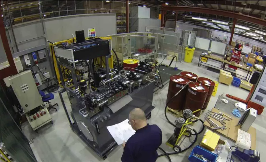

This test stand has guarding that protects the operator against a crushing injury. The doors are closed when the machine is in operation, and they are opened when the machine is idle. Optical finger switches initiate the start cycle. The test stand also has an electrical switch to lower and raise its height.
